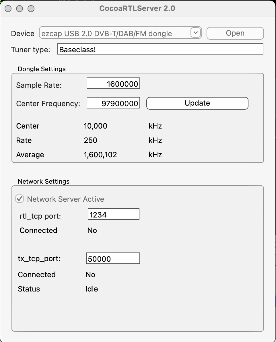

I should add, I have also installed CocoaRTLServer2dist and while it shows the following
I never get any signals on the map. Which I assume is based on the error in the above post.
Either your USB port is faulty, your SDR dongle is bad, or you don’t have the correct driver installed (if MacOS needs one.) Reboot your computer, plug the dongle in, then check if it’s listed in your USB devices.
I assume this is an equivalent to rtl_tcp. If you have that running, it will have claimed the dongle exclusively and other utilities such as rtl_test won’t work.
