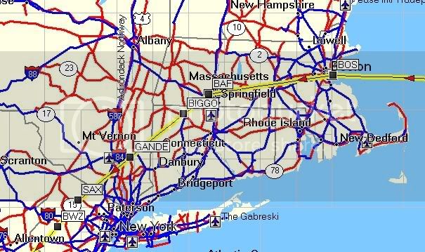

I took the liberty of plotting the appropriate points in my GPS software. Here’s the big picture of WHALE to J77:
…and here is J77 (Pink Highlighted line) zoomed-in locally:

It turns out I live on the line (vector?) between BOS and BAF. It looks like that is the same as route J77 on the H12 chart. Pretty cool!
