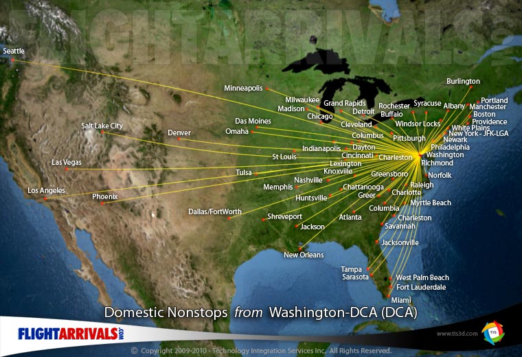

Alaska Airlines is flying 737s nonstop from DCA to LAX and SEA.
USAirways is flying A319s and A320s nonstop from DCA to PHX and LAS.
Although there are currently no Airbus flights from DCA to a west coast city, there are several from IAD.
Some obvious choices for new destinations are SFO, LGB, SAN, PDX.
