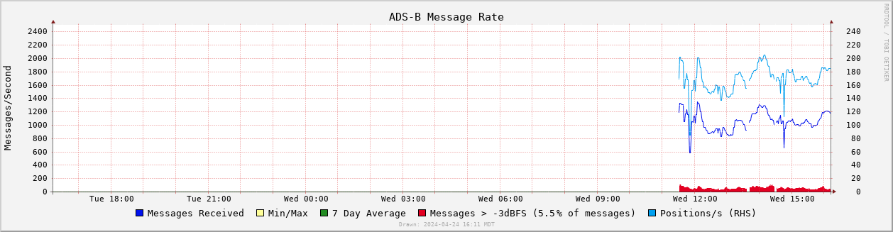

To all my teachers…here’s what I have so far…
Many thanks to all who chimed in to teach this grizzly old buzzard some new tricks!!
J
Your graphs look fine for this moment, maybe post a second series after 24 hrs, that will give some more insight :+1:t2:
