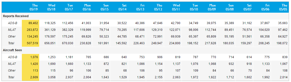

I’ve been using the Flightaware antenna and recently added the Pro Stick/Filter combo. They have made a big difference for me and looking at my screenshot it is clear when I installed them. :slight_smile:http://uploads.tapatalk-cdn.com/20160517/cfa5e32d0be61f6f7f3afe4f366ad2dc.jpg

I had similar experience. Increased performance 200%!
Amazing!
I’m jealous!
