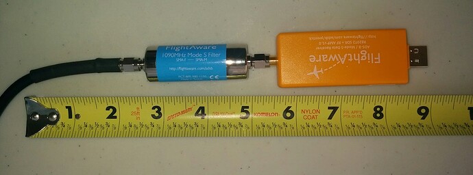

Could I get you to do me a huge favour, can you give me a measurement in millimeters, the length of the dongle and filer together, maybe also include an sma and coax on the end curved to 90 degrees as is safe for that size coax…?? Just want to know if I need to go buy a larger outdoor enclosure than what I already have.
Thanks!!
@bhaal
In my opinion, in order to reduce mechanical stress caused by push/pull/weight of heavy feeder coax like RG6 on the Stick & Filter’s delicate SMA connector, it is advisable to use a small 4 inch or 6 inch long pigtail (made of thin cable like RG174 or RG316) between feeder coax and the filter (or the pro stick if no filter is used).
The size is 6.5 inch (165 mm) for the Prostick and filter
If you want to include the space for cabling you should add another 2-3 inches. About 9 inch (228mm)
Thanks David! Much appreciated, now I know it’s not going to be easy to enclose that as a single length, will have to figure something out at least I know the length now :slight_smile:
