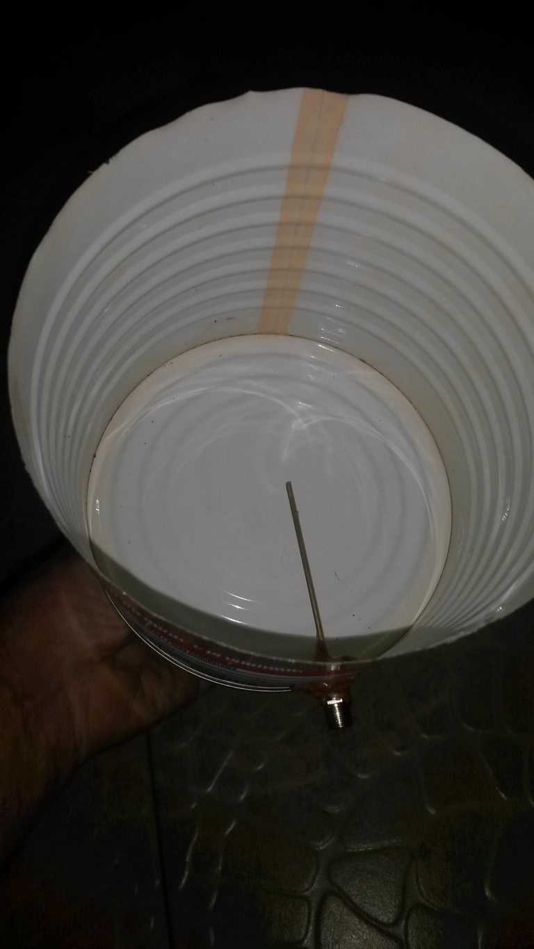

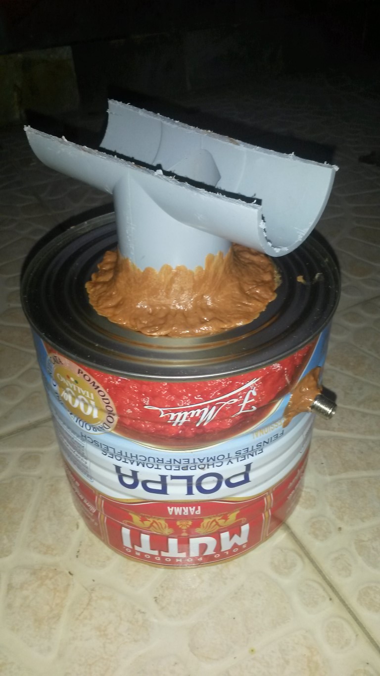

MY ANTENNA EXPERIMENTS :slightly_smiling_face:
IMAGE 1 of 3
IMAGE 2 of 3
IMAGE 3 of 3
Aint experimentin’ fun? :wink:
Yes, it is. I enjoyed it a lot, but for last almost a year did not do any experiment on DIY antennas.
The Cantenna is sleeved dipole’s wide-bodied version.
I have performed trial runs on 3 sizes of sleeve dia, and the performance improved substantially as the diameter was increased from 20mm to 54mm to 68mm. Best out of 3 was Cantenna with standard Pepsi can 68mm dia.

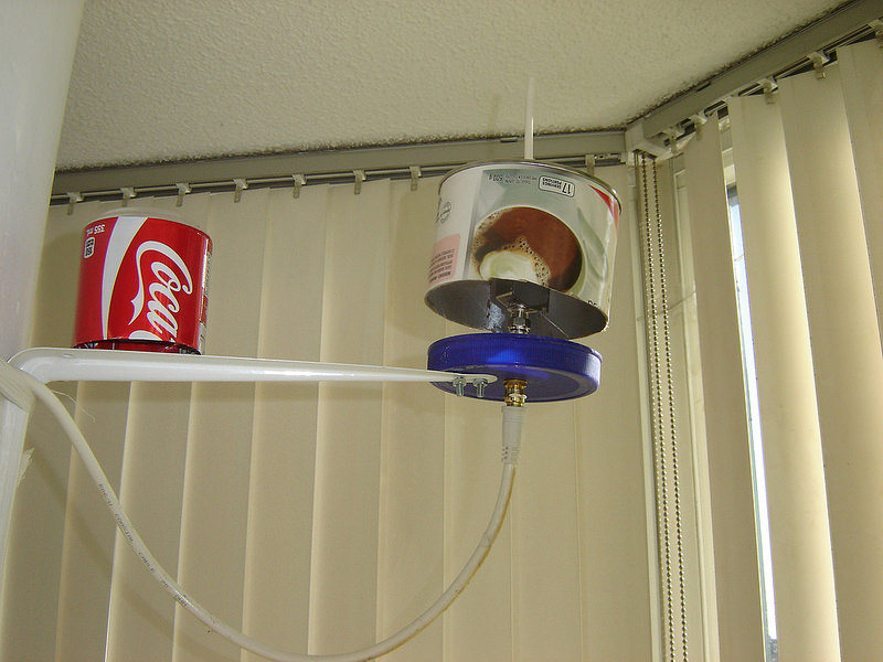

This is one of those FWIW type of things, but since the term and antenna have been around since 2007,
it would appear the name Cantenna is commonly understood to mean one of these:
http://www.turnpoint.net/wireless/cantennahowto.html
A long time before that, it meant one of these:

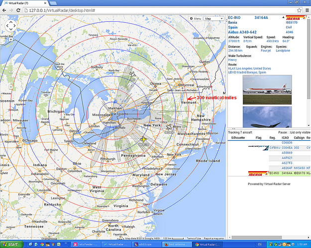

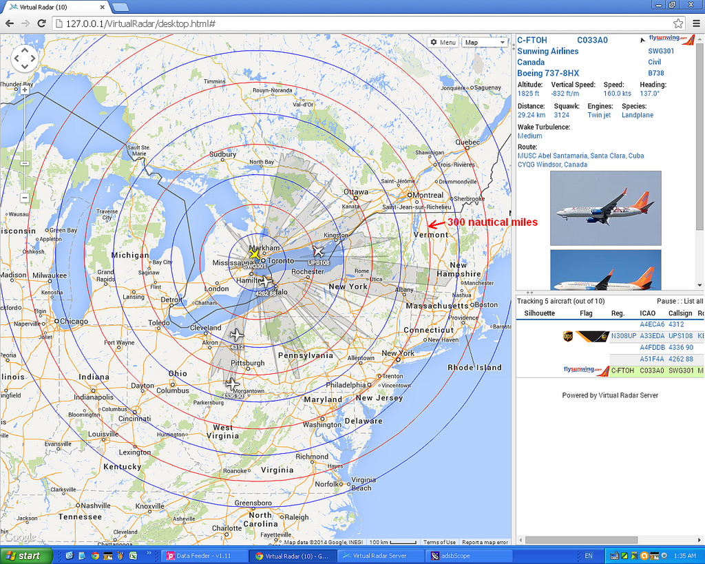

August 2014 - Cantenna Can Size Comparison 68mm dia vs 100mm dia
Image 1 of 3 -Setup
Image 2 of 3 - VRS Range Plot - 68mm dia Pepsi Can
Image 1 of 3 - VRS Range Plot - 100mm dia Coffee Can
