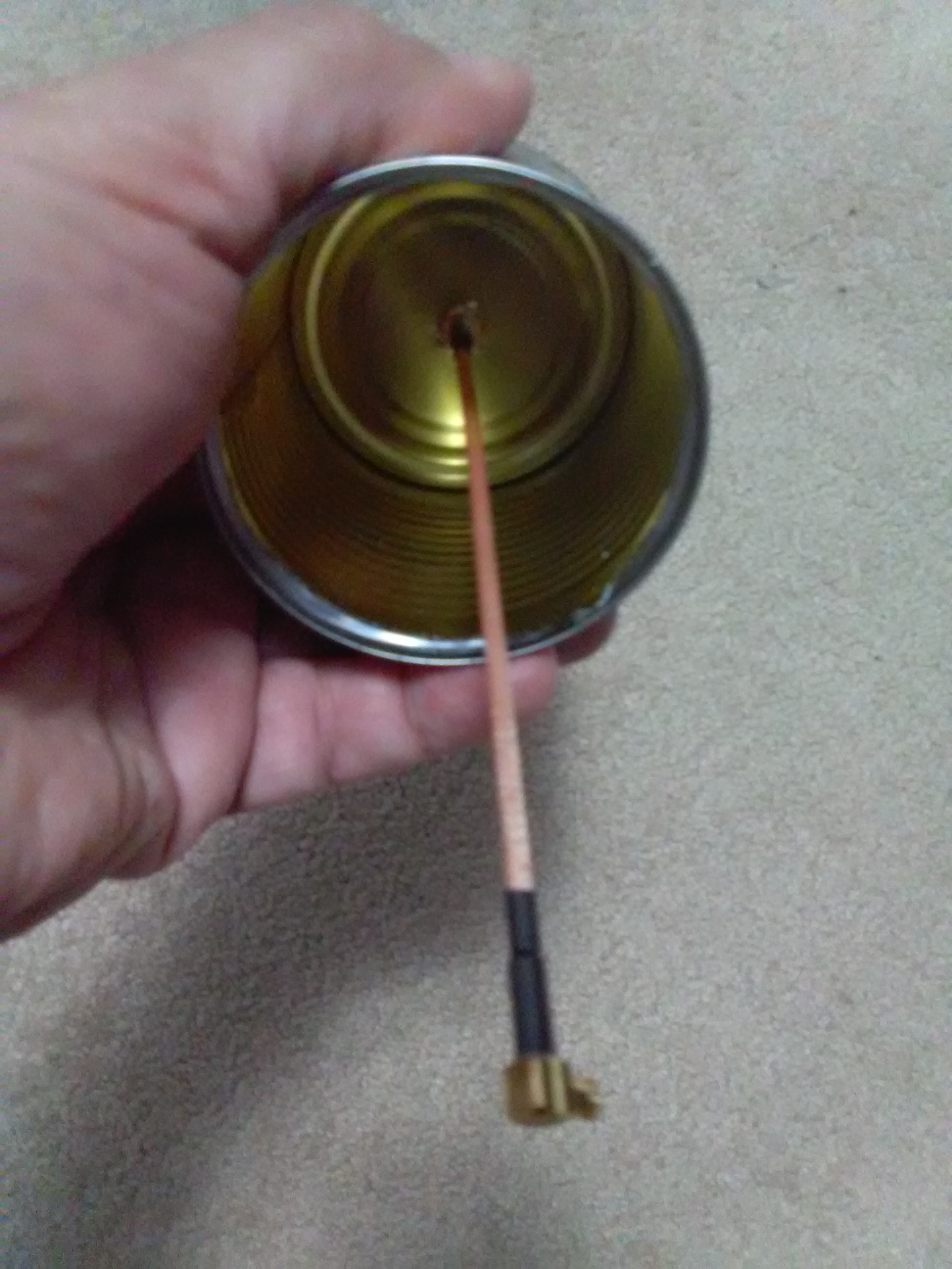

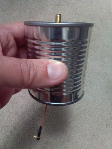

Pictures showing the ‘new ground plane’ of the antenna being modified. Note the use of the SMA to MCX jumper that was included with the unmodified antenna.
More tomorrow, showing the antenna itself.

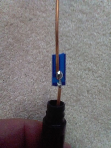

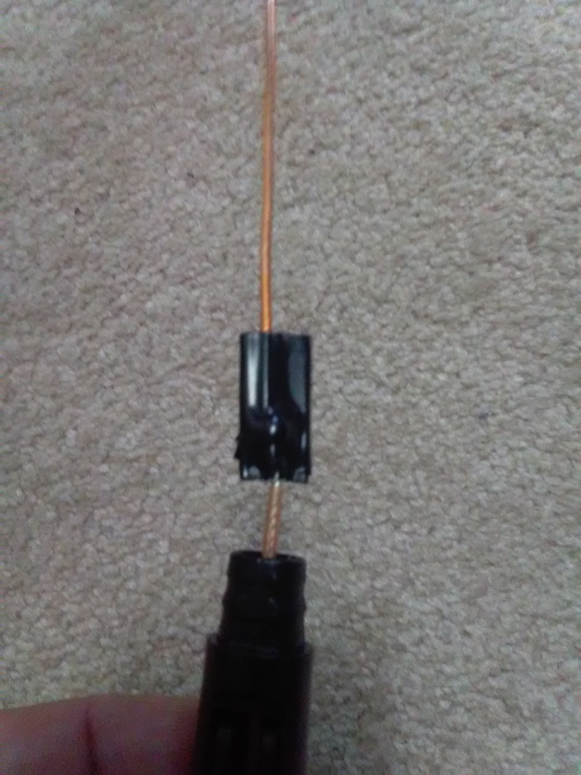

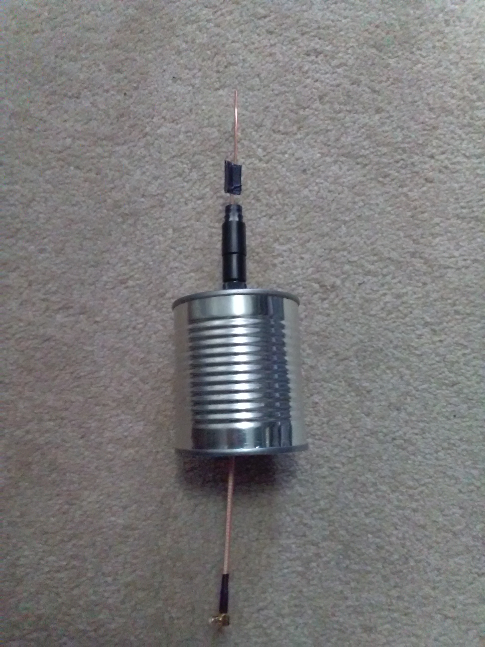

Pictures of the antenna and the complete assembly, henceforth referred to as the ‘contraption’.
After about 4 hours of work, and countless up and down a step ladder, plus up and down the stairs to the computer room, a brief report follows:
I built two antennas, one had a problem. This was good as I could see right away what a bad assembly looked like reception wise.
The antenna worked, but it took a lot of trimming. It does seem to be impacted by the cap/cover, since the best results were with a length shorter than the calculated one.
Performance differences were obvious right away. The ‘contraption’ is worse than the QuickSpider. It’s even worse than the little mag mount, trimmed to the correct length, when on top of the can/ground plane.
The FA antenna is still king. The QuickSpider is the next best. The ‘contraption’ has been ‘round filed’.
To paraphrase the great philosopher Homer Simpson in his Dialogues with Bart: “Son, you tried hard and you failed miserably. The moral of the story is: never try.”:persevere:
I kept the ground plane in place, as it can be used in future experiments. Worst case scenario, as described above, it worked fine with the little mag mount.
P.S. FA robot, back off.:rofl:

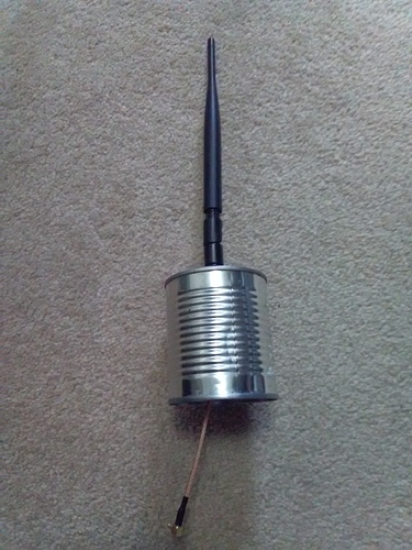

Try this
dxita%20cantenna-1
cat-6-cable-500x500

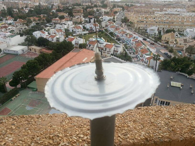

The “tuna fish can bottom” antenna
An excellent example of cutting edge technology. :slightly_smiling_face:
Seems the can was not opened by a tin-cutter / can-opener, rather hacked. :slightly_smiling_face:
tunafish-can-groundplane
