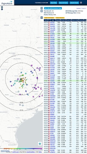

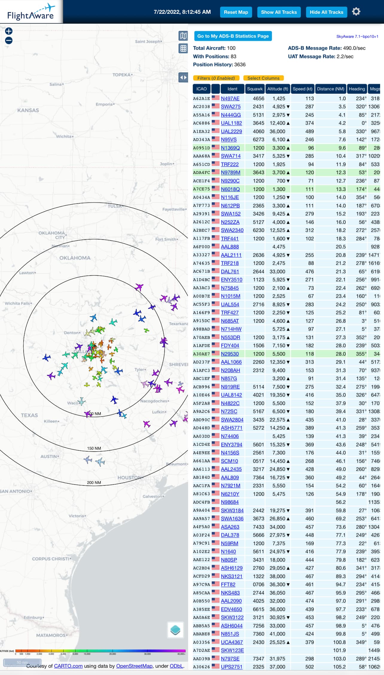

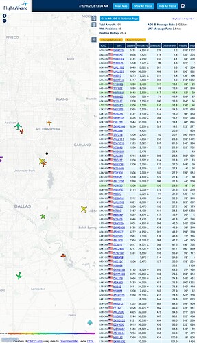

The issue I am specifically facing presently is when viewing my SkyAnyWhere maps from a mobile device or even a desktop. No matter how much I zoom in to the map side of the interface. The plane and helicopter icons remain the same size. To me this defeats the purpose of zooming. I can see where everything is located but on a mobile device if I zoom down to street level and a Airbus A380 is the size of a motorcycle, that doesn’t help me. More specifically I am looking to make sparse groupings of aircraft larger so I can select individual ones.
But I have not been able to find the code to change any of the settings. I would like the icons to enlarge as I zoom in until at a certain point they stop getting larger and then level off. Instead of remaining the same all the time. And I am hoping the community can help me!

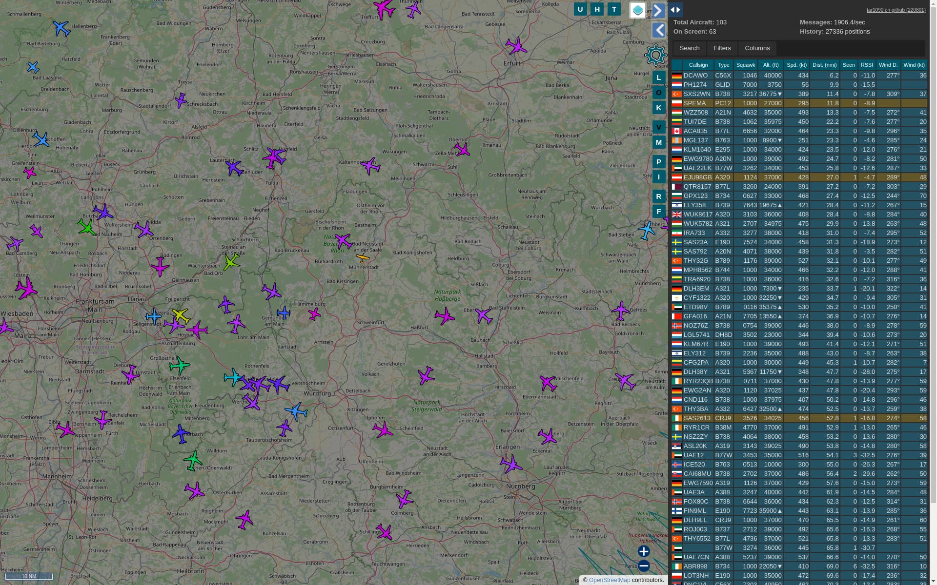

You can have a look at tar1090 an alternative map which runs beside Skyview on your device. There you can change the size of the icons

Default behaviour of tar1090 is to switch between these two icon sizes:
There is a slider in the settings menu (gear wheel) to generally change the icon sclaing.
