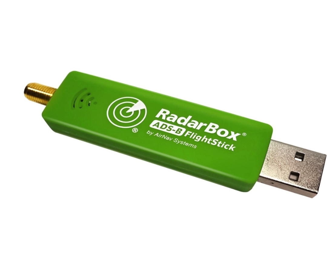

Thanks for the replies :slight_smile: One last question, will the items in screenshot below work with each other out of the box or will I need some form of connector?
chrome_2019-01-19_15-14-04
it’s hard to see on that picture what that dongle has for a connector but probably SMA.
the antenna has an mcx connector and the dongle an SMA connector so that wouldn’t connect.
edit: i checked the radarbox store and the dongle doesn’t even state what connector it has.
the antenna says it has an mcx connector but the picture shows an SMA connector.
maybe contact the store and tell them :stuck_out_tongue:
Thanks for the clarification. Rgds.
The RadarBox FlightStick seems to have a SMA connector
