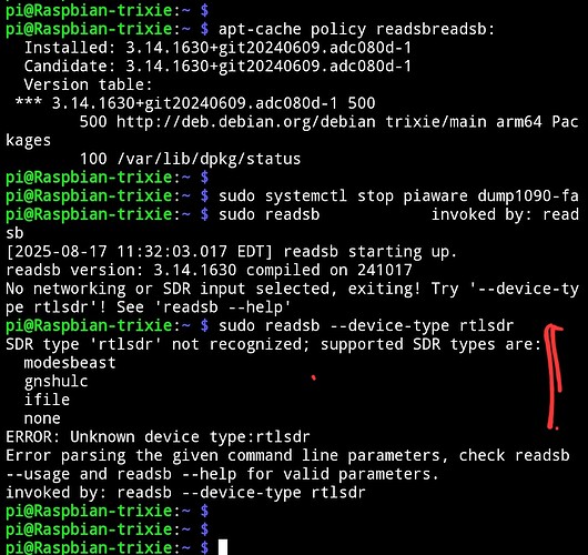

There is a readsb .deb package available in raspberry pi repository, but unlike your version, it does NOT support rtlsdr i.e DVB-T, FA Prostick, etc are NOT supported by it.

Well it is my version (from last october), it’s just built without rtlsdr support.
Also comes without a webinterface.
Let’s see if the maintainer will answer, i somewhat doubt any changes are gonna make it into stable, but maybe the next stable :slight_smile:
They claim it to be for RTLSDR as well :frowning:
