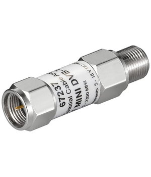

I use this antenna myself COL1090/5-H Vinnant
And such an amplifier
Amplifier
stiprintuvas
F plug to F jack (5-2300 MHz)
slim-design.
thickness as a coaxial cable
suitable for DVB-T/SAT
water resistant with rubber gasket
for outdoor mounting
frequency range 5-2300 MHz
75 ohm
max. 5 dB noise figure
gain 18 dB
power requirement 5 V-18 V/25 mA via receiver
dim.: 43 mm x ø 11 mm
The amplifier should be mounted on the antenna, not some mount on the receiver.
It receives signals within 400 km.

The antenna in the OP has a 20dB amp (claimed) and possibly a SAW filter.
Site 85260 uses a basic PCB antenna. The asymmetric pattern is due to terrain, and flight path traffic rather than lobes on the antenna. That’s not to say the antenna doesn’t have lobes, just that they don’t dominate.
As low gain antennas go, PCB antennas perform ok. Adding an amp isn’t a substitute for a better antenna, but it will compensate for cable losses.
That’s an elegant amp.
I tried searching for the model number but didn’t find it.
Being a general purpose amp, it is very broadband and would probably make things worse if you are near any transmitters unless you added a filter too.
The 5dB nf leaves room for improvement, but the package make it easy to work with.
Here’s a link.
Thanks - now I’m finding then all over the place.

Here ya go
https://produktinfo.conrad.com/datenblaetter/1100000-1199999/001195433-da-01-ml-GOOBAY_MINI_KOAX_KABELVERST_DVB_T__de_en.pdf
