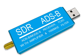

I’ve recently brought a cheap dedicated ads-b receiver from China, not a fake copy one, but something that looks like it has tried to do it’s own thing… Is it ok if I was to post a quick review here, I know you guys sell your own equipment…

I saw one of these on Aliexpress a while back and as I was looking for something to replace an RTL-DSR v3 and wideband LNA that I was using on my secondary receiver, I got one on a whim when it was offered for £18…
To be honest wasn’t expecting a lot, the description was cobbled together from a standard TV stick listing, didn’t make any sense in the context of ADS-B, and it was plastered with buzz words, however since I’ve got it I’m quite pleasantly surprised.. It seems well made, metal can, that gets quite warm, so there appears to be an effort to drain the heat away inside…
Performance wise, a direct swap with the RTL SDR saw a reasonable jump in message rate, from about 650/sec to 850/sec average and a modest rise in distance, maybe 115 miles average to 125…
I ran a heat map to compare against my flightstick blue, and RTL SDR setup, while to my untrained eye the filtering does not seem to be of the same quality as the flightstick, there does seem to be some there..

On ebay I’ve seen them for £35, certainly at that price I would get pay the extra and get the flightstick but if you can get one cheap they look like they would make quite a good dedicated secondary / backup device…

I’ve got a couple of those as well, they are a decent replacement when stick fails, only downside I’ve experienced is that they don’t like to be placed behind a barrel filter and LNA.
Then the performance degrades quickly so I use them without those items.
