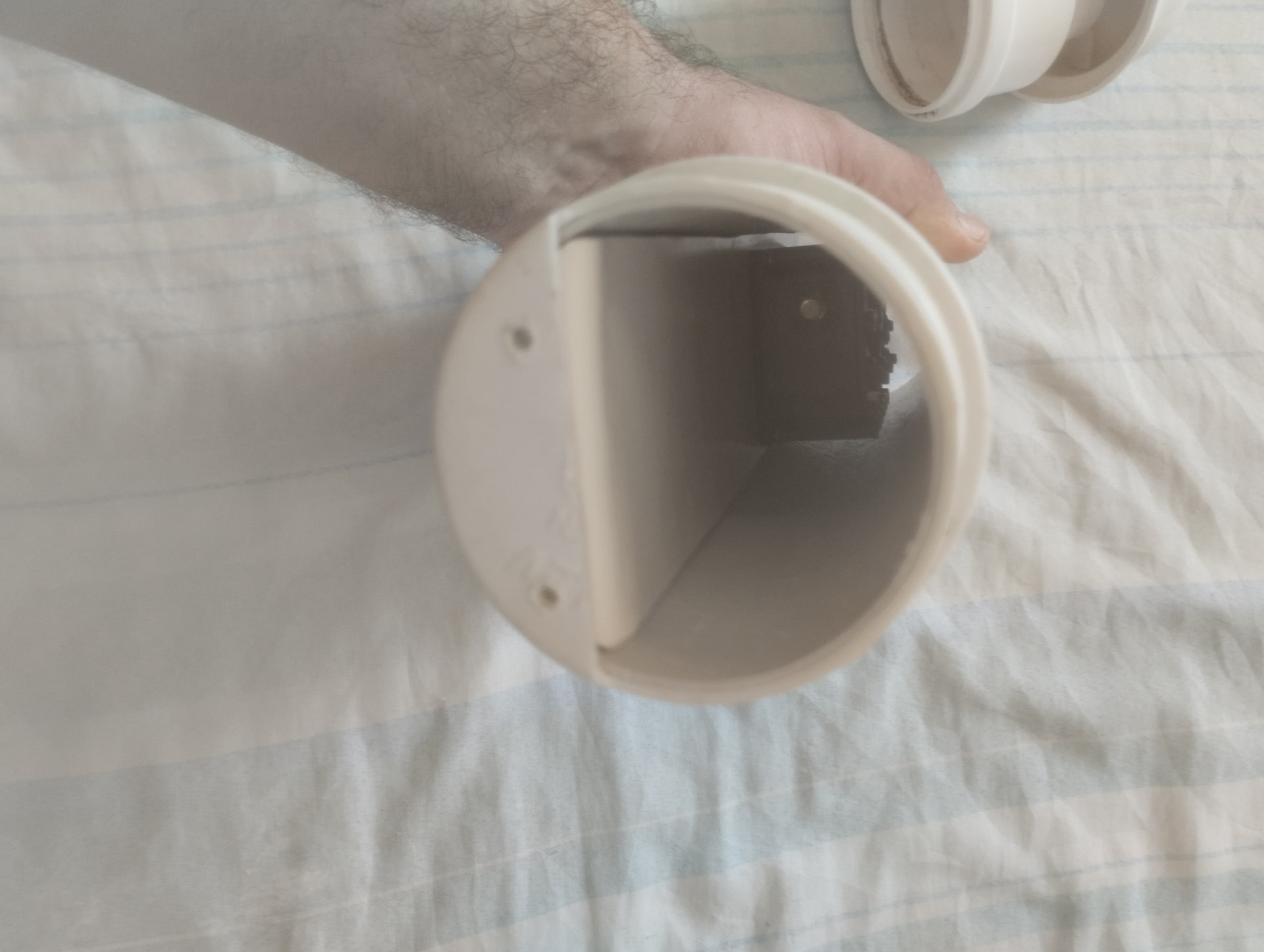

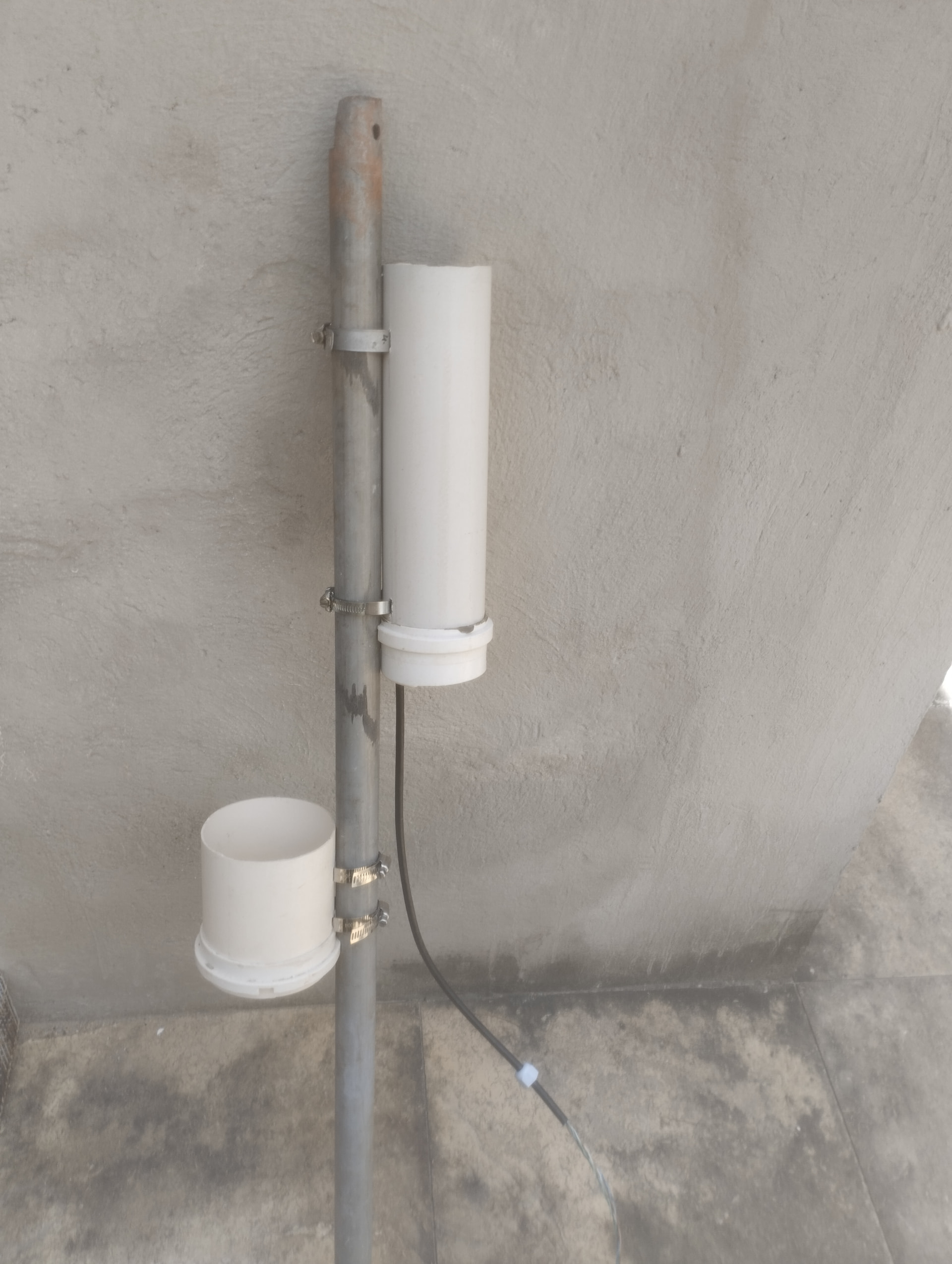

Take a look at my Piaware DIY: A 100mm PVC pipe with cap for the RPi4 + XL4015. UTP cable (100% CAT5 copper) with ferrites and filter capacitors for frequency between 150KHz-180KHz (from XL4015),working as USB cable. Another 75mm PVC pipe for cavity filter + SDR with sink. Pipe with modified lid, as if it were a chimney to escape hot air. Pigtail: coaxial cable 34.2 cm (length corrected by the cable spread factor). All this powered by 12v PoE. It will be on a 25m high mast.
