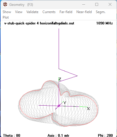

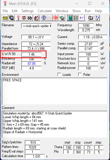

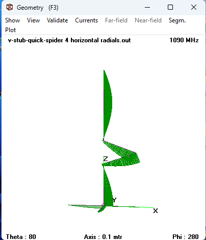

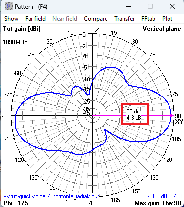

When you are finished with testing the Cantenna, you can try “V-Stub” ground plane antenna, details of which are given below: Although I could not measure the Gain value as I dont have such costly equipment, I have done a Computer Simulation which shows it has a gain of 4.3 dBi which is 2.1 dBi higher than 2.2 dBi of Spider and Cantenna.

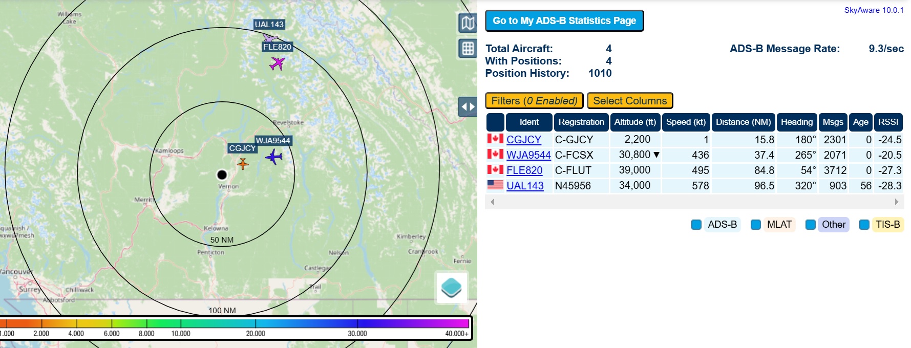

I have another question for the group, at what RSSI level do your signals start to drop off, with my current spider 1/4w in the living room I get about 55-60nM max, and an RSSI of -28. Just wondering what you flatlanders get in better conditions?
Cheers

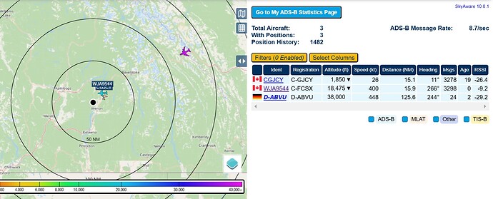

Well wooohooooo! Rain stopped, I put up the cantenna, no preamp, just 12’ of RG-400 into the RTL-SDR and I’m seeing planes out at 125NM at -29dBi, amazing the difference. Antenna is only about 15’ above the ground, 6’ above the roof, cool!
The heywhat’sthat prediction is pretty darn accurate, planes dissapear in the nulls and pop out again where it says they should. Neat stuff.

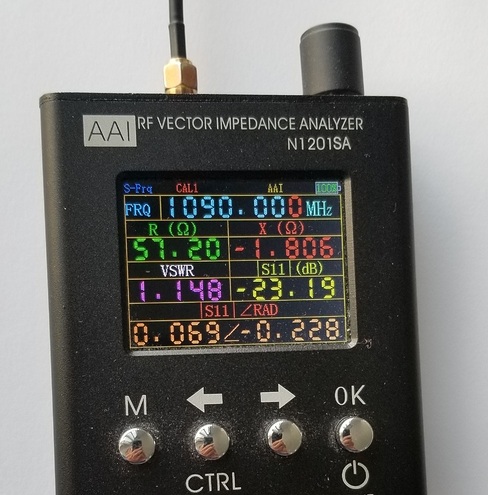

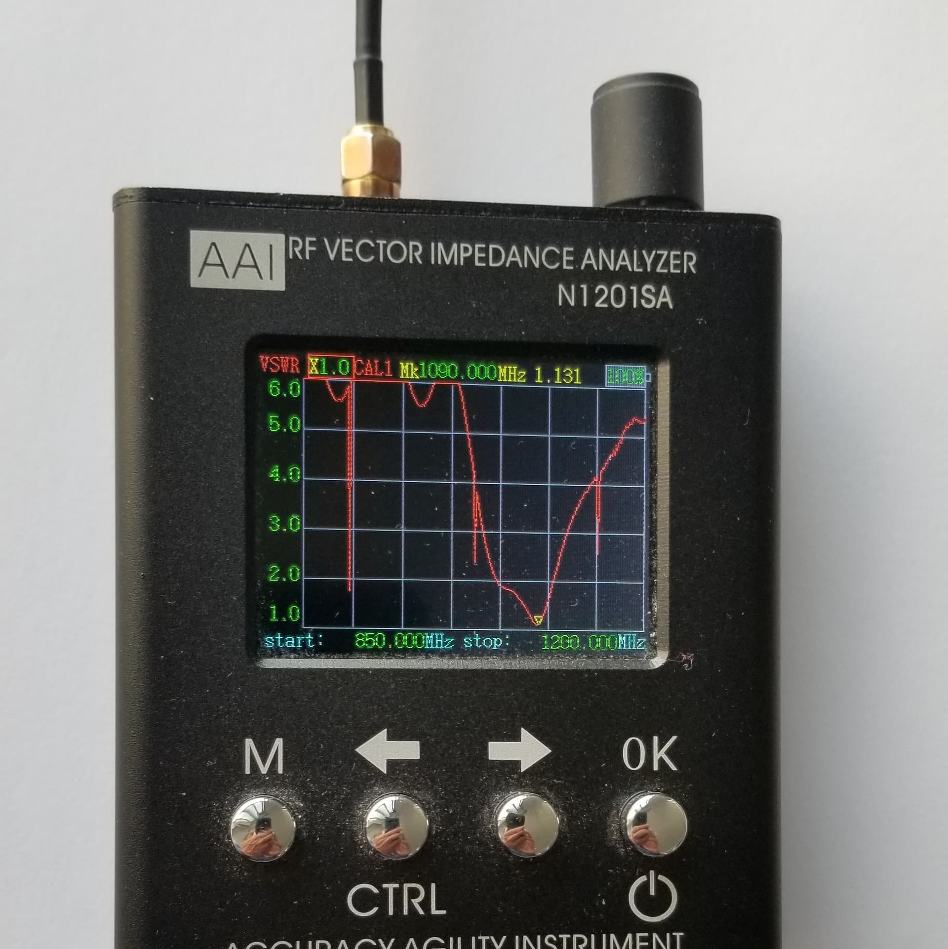

what analyzer is that? Charlie
I t is:
RF VECTOR IMPEDANCE ANALYZER N1201SA
Please see it’s name on full photo of analyzer attached below:
That is real nice. Thanks.

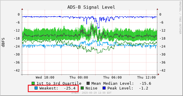

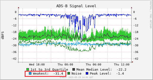

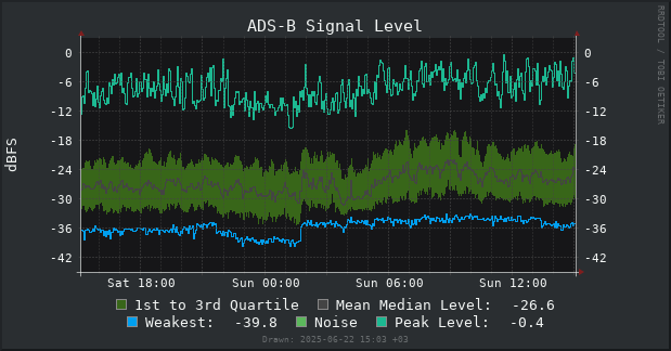

Max Range = 540 Nautical Miles,
Avg Max Range = 352.9 Nautical Miles
Weakest signal Strength = -39.8 dBFS
What is your setup i.e.
  • Antenna: type, location & height
  • Coax: length & type
  • Filter, if any
  • RF Amplifier (LNA), if any
  • SDR (Generic DVB-T / Flightaware Pro Stick / Radarbox24 Flight Stick / AirSpy Mini etc)
