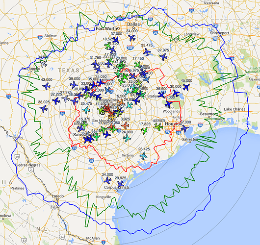

I see what appears to be two range plots. I only have a green one on the addons I loaded. Did I miss something??
Those are terrain limited range predictions provided by the API on heywhatsthat.com. Oliver added support for those. Here’s the instructions:
// Add terrain-limit rings. To enable this:
// create a panorama for your receiver location on heywhatsthat.com
// note the “view” value from the URL at the top of the panorama
// i.e. the XXXX in heywhatsthat.com/?view=XXXX
// fetch a json file from the API for the altitudes you want to see:
// wget -O /usr/share/dump1090-mutability/html/upintheair.json
// 'http://www.heywhatsthat.com/api/upintheair.json?id=XXXX&refracti$
// NB: altitudes are in meters, you can specify a list of altitudes
You can have as many as you like at different altitudes.
I have one set at 40,000 ft (blue) and one at 10,000 ft (red) . The 40,000 somewhat corresponds with the actual (green). Interesting that I don’t seem to get as far over the gulf as predicted. That could just be lack of high level flights pushing out the actual polygon.
