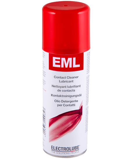

I use one of the Contact Cleaner/ Lube sprays.
eg
Thanks, but that’s not really a kind of swab. I’ll consider using that in addition to using a swab.

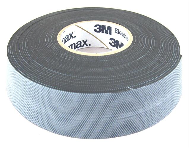

RE: @CraigWoodThomas
“Heat shrink that new cable connection to keep that microburst moisture at bay!”
I use this from DX Engineering. Waterproof.
I used Duck Brand Wrap-Fix Repair Tape, 1-Inch by 10 Feet, Single Roll, Black (442055)
