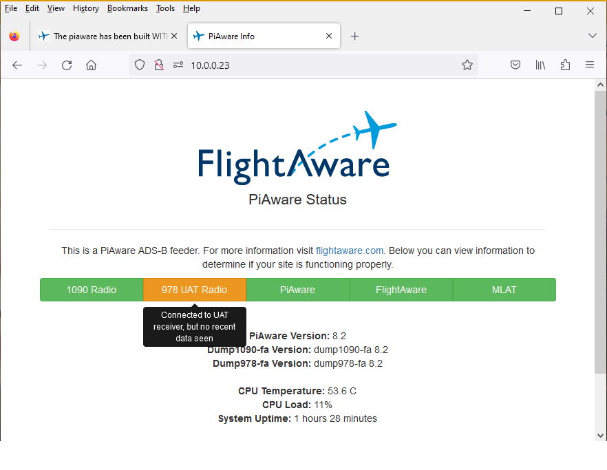

The piaware and dump1090-fa and Skyaware Map install and work OK on Bookworm AMD64 (PC) and ARM64 (RPi).
The dump978-fa also installs and works OK on Bookworm AMD64 and ARM64. It receives UAT aircraft. However the Skyaware978 Map show a perpetual rotating wheel :slightly_frowning_face:
RPi Model 4, Bookworm 12.1 - SITE 76000
