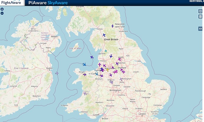

Well I have news, I spent the last couple of hours on and off getting things working. I gave up on Ubuntu 24.04 LTS and went for a 22.04 LTS VM instead. I didnt go the LXC route as I had issues in the past passing through some devices but your notes may clear this up, if I do go down that route in future, so thank you! I built both the deb packages for piaware and dump1090, had some problems with tcl-tls_1.7.22-2 but found that on github and downloaded and built.
I have literally just plugged in the usb and found the web page on port 8080, so far very impressed.
Unsure how well my aerial is working at this point, its a ham tri band colinear for 144/432/1200 Mhz, so its not ideally tuned for 1090, we shall see!
Not done any other tweaks or checks as yet.
