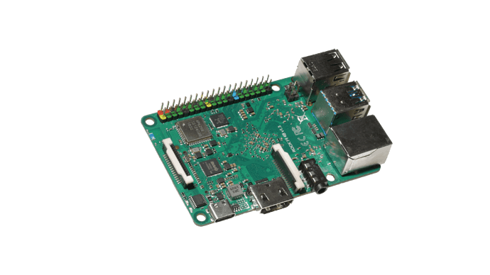

:+1: Great to hear mate. Keep us informed about your thoughts on this SBC after having run it awhile. I personally like it alot and it’s the only SBC I’ve tested that can run an Airspy R2 full-tilt along with an RTL-SDR radio doing UAT and a USB GPS dongle all plugged into the same device without dropping packets/MLAT.
I also swooped up a RockPi S for some tinkering - neat little package, also runs well:
https://wiki.radxa.com/RockpiS
It’s my hope these guys keep up with the support since I think they are putting some good products out.
I have the same RockPi set up as Nitr0, because of him and this thread :slight_smile:
I concur, works great!
Powerful and functional.
Cool to hear. They should send me something for pushing their product :rofl:
I just tried a few things with the mainline Debian desktop kernel and well as DietPi and both proved to be trash for the RockPi4. The only way to work cleanly on this board with Linux (in my opinion) is to use Armbian Buster (right column).
Default login is root/1234
They have some really nice first-run scripts that will help you setup your locale, user, etc. Armbian has come a long ways and is really nice to use.
