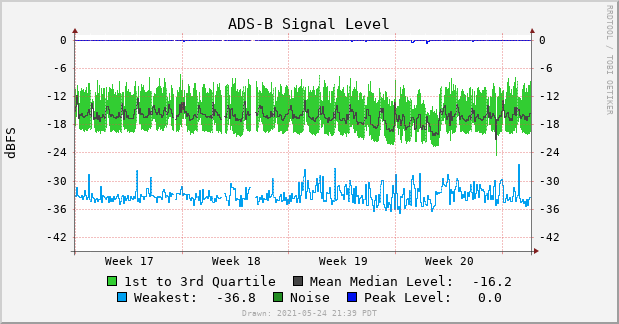

I suspect connectors. But one thing I remembered, the first couple days of signal decrease were dry but unusually gusty/breezy almost all day for a couple of days. The N connector was still tight, sealed and dry when I swapped antennas while troubleshooting. I’m wondering if there was maybe stress from the wind somewhere in the zip tied cable run 33 feet up the mast.
Anyway, all is well now. My signal first mostly recovered May 19 by connecting the 978MHz antenna and cable while waiting for the new cable for the 1090MHz antennad to arrive on May 22.
dump1090-localhost-signal-14d
dump1090-localhost-signal-30d
