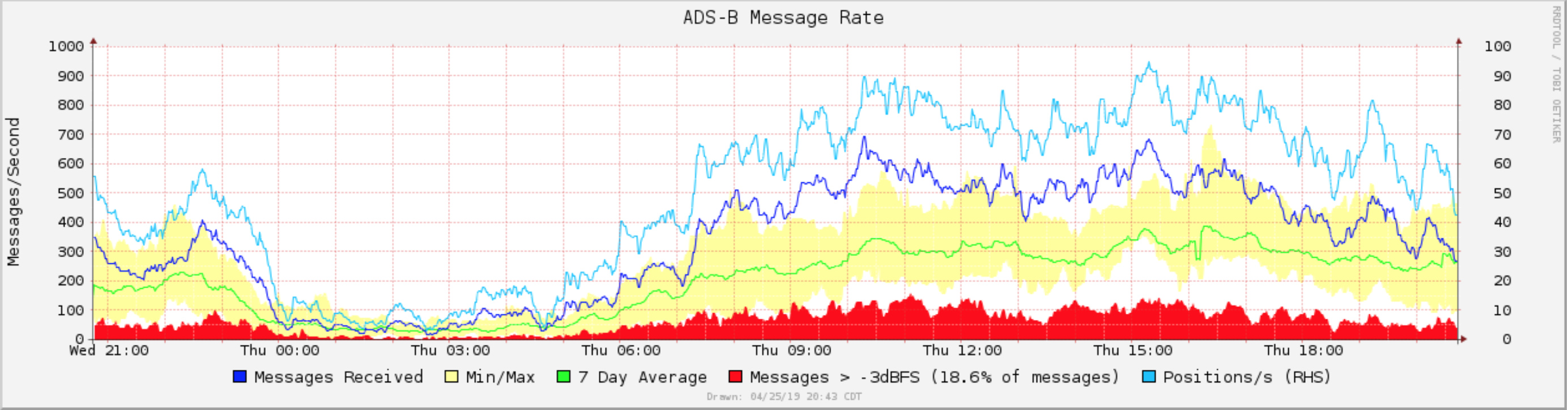

Now, positions is an area where I don’t have a shortage. As @wiedehopf indicated, positions increased in numbers when the gain went down a notch or two. There’s plenty posts about gain setting. The performance graphs are a big help.

Which graphs you have?
I use
(1) RSSI column of dump1090-fa table. This column is visible after you expand the table to full width. Then twice click on the RSSI column heading to sort values high to low (0 is highest, -1 lower, -3 still lower, -20 still lower).
(2) I have installed graphs by @wiedehopf by following command:
sudo bash -c "$(wget -q -O - https://raw.githubusercontent.com/wiedehopf/graphs1090/master/install.sh)"
Please see this site for details:

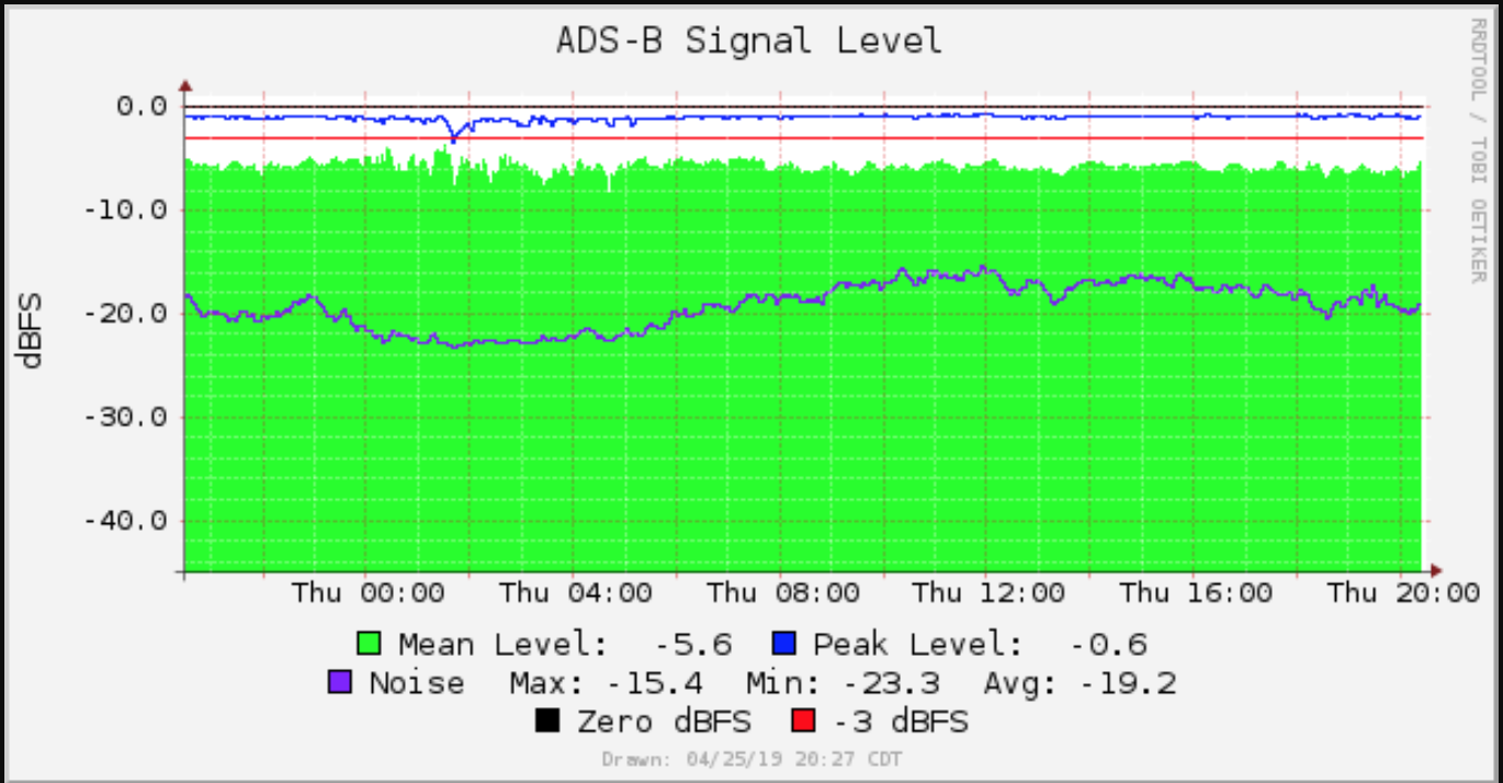

Here are the graphs for today for the signal level using the -10 gain:
Experiments to lower the gain have resulted in little/no seeming increase in either messages or spotted planes. So, that’s where I am so suggestions welcomed!

If you are at AGC right now maybe try 49 first and see how the red percentage changes.
Then try 46 for a day.
And I want the red percentage to be 5% optimally?
You want the best SNR, not absolute highest signal. Lower the gain, most times the SNR increases, and performance improves.
The link i posted somewhere above talks at length about that.
It depends on what you want.
But as you mainly seem to be interested in improving the numbers 5% is a good place to start.

I have an identical setup to yours and had the same issue with close aircraft overloading the receiver (I’m about 5 miles from a primary LAX departure route with constant traffic). I played around with the gain and found best results were when the % above -3 dB (the red) was between 3% and 5%. Also at this setting my noise floor trace was about 10 dB below yours, typical highest level is -28 dB or so. I pretty routinely get hits at -32 dB before losing aircraft, often below the reported noise floor.
My setup has about 5 dB of insertion loss between the FA antenna and the pro-stick plus and the optimum gain setting was 33 dB. Positions have increased ~30%, aircraft ~15%. Here’s a typical signal level plot when I have good performance.
When overloaded the close in aircraft will drop positions and won’t be counted. You can see this happening in the dump1090 plot where the close planes don’t show a solid trace but have gaps.
