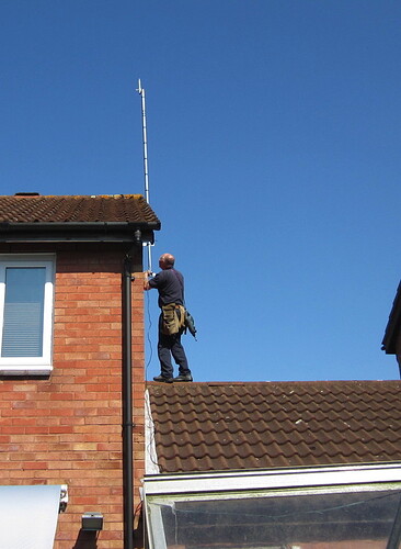

Yes, I just had the antenna relocated on the roof. Unfortunately the Nexus is running on batteries as I am still awaiting a lead from the US that will hopefully let me charge it at the same time. So you will only get a couple of hours at a time before I have to recharge it,
It does seem to be working well now, getting out about 170 nm.

The antenna is a custom built one from Slovakia found on eBay. It cost around $30 including delivery. It is mounted on a post six feet above roof level and is about 50 ft from the receiver. The dongle is at the Nexus, I would not want to have to go up on the roof to replace it. T am not using an amp or filter but I might consider it later if there is any advantage. I think the antenna has enough gain. It is described as a 5/8 type with a gain of 3db.
