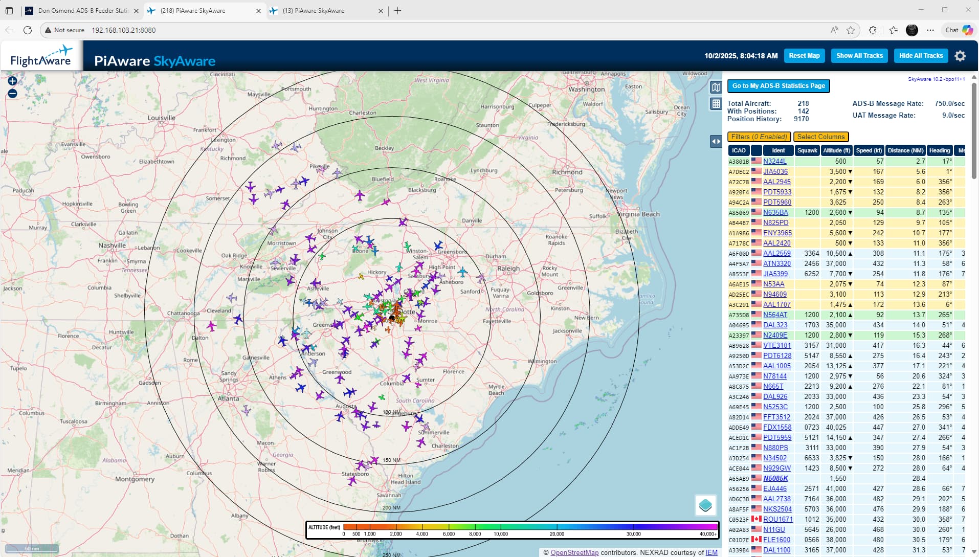

Here is an update on my Antenna Placement project. This is the view this morning.
This is the graph for the last 14 days. First 7 is pre change and last 7 is post change.
You can see the improvement. The 1090 antenna is at same height for 1090 in all of the days, so the LOS aspect did not change. But the change to the coax (now LMR400) and shorter length (now 25’) allowed the 1090 dongle to be receive a less attenuated signal.
The 978 antenna is below the 1090 and is a FlightAware ADS-B Dual Band 6dbi with LMR400 (25’) to the 978 dongle.
My home is at an elevation of 610’. The base of the DX Engineering Fiberglass Tubing is at 632’. The base of the 1090 antenna is at 653’. The airport elevation for ATL is 1026’, CLT is 748’ and RDU is 404’.
The enclosure for the Pi 4 is an outdoor electrical box with thermostat and fan, IP65.
Going to let this sit for a while. Thanks for the comments during this project.

Well done, enjoy the new toys :+1:t2::wink:
Don, I have your six. My 200NM limit to the north comes in around Savanah. Love that 2nd floor wrap around patio porch. That’s a great antenna base site.
That is some impressive coverage.
