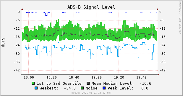

Last year while testing Airspy over the first month, the sweet spot for positions, aircraft, and range seemed to land with Mean Median signal level around 15.5 to 16.5 for my station in the trees. This mean median goes down below 18 when my map is dominated by low flying GA aircraft on sunny days and closer to 15db on rainy days with mostly high flying commercial aircraft on the map.
Every station is different and a few db up or down doesn’t seem to change much with Airspy stats. Just sharing this example since it is what gave me the best results. I’ve also seen roughly similar graphs from other stations with way more impressive stats than mine!
dump1090-localhost-signal-2h

I think a gain of 21 is probably too high unless you have no LNA or some pretty unique situation like limited antenna. Airspy is pretty robust translating the -0db messages, but I’d still recommend letting a lower gain bake for at least half a day before passing judgement. Going from 21 to 19 equals -6db gain.
Even at gain=19 with the Uputronics my peak signal line stays flat at -0db during peak hours.

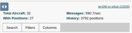

Values on gain 21
Values after setting gain to 19 and -e 10.8
No significant change, will keep it for a while. The two more aircraft just appeared on the map after the change coming in range
Number of Aircraft with “0.0” in RSSI is lower
Maybe it is more efficient on higher traffic.
