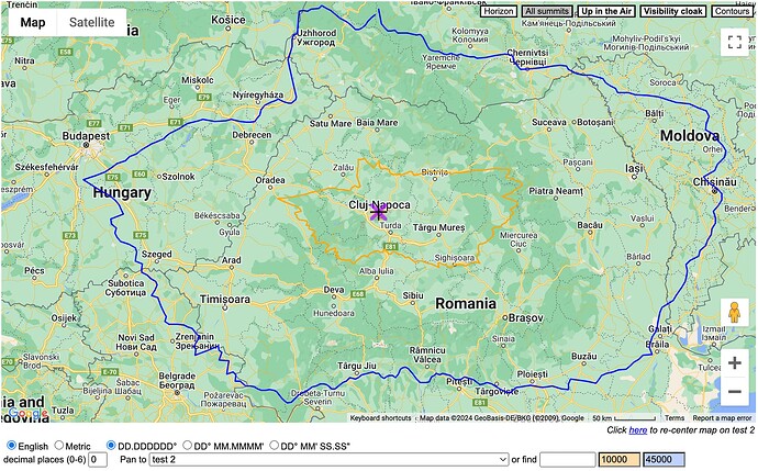

Current range and maximum range acording to HeyWhatsThat:
The antenna is not suitable for outdoor use.
It only has an average of 3 dB amplification so don’t expect big steps in the improvement of your reception.
