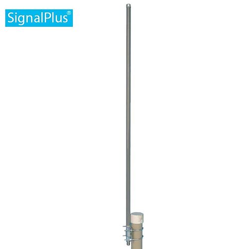

Has anyone seen this antenna in the size of a broom stick? 8.5dBi is this really possible?
Considered ordering it just to try it out, but it turns out that the shipping cost was higher than the cost of the antenna. 50+ euro for the shipping was a bit too steep for me…
Have you checked if you can source it locally? Worldwide Distributors - Pimoroni
I’ve contacted a couple of resellers here in Sweden. Hopefully they can help me out.
This antenna begs to be tested and compared to the FA-antenna…

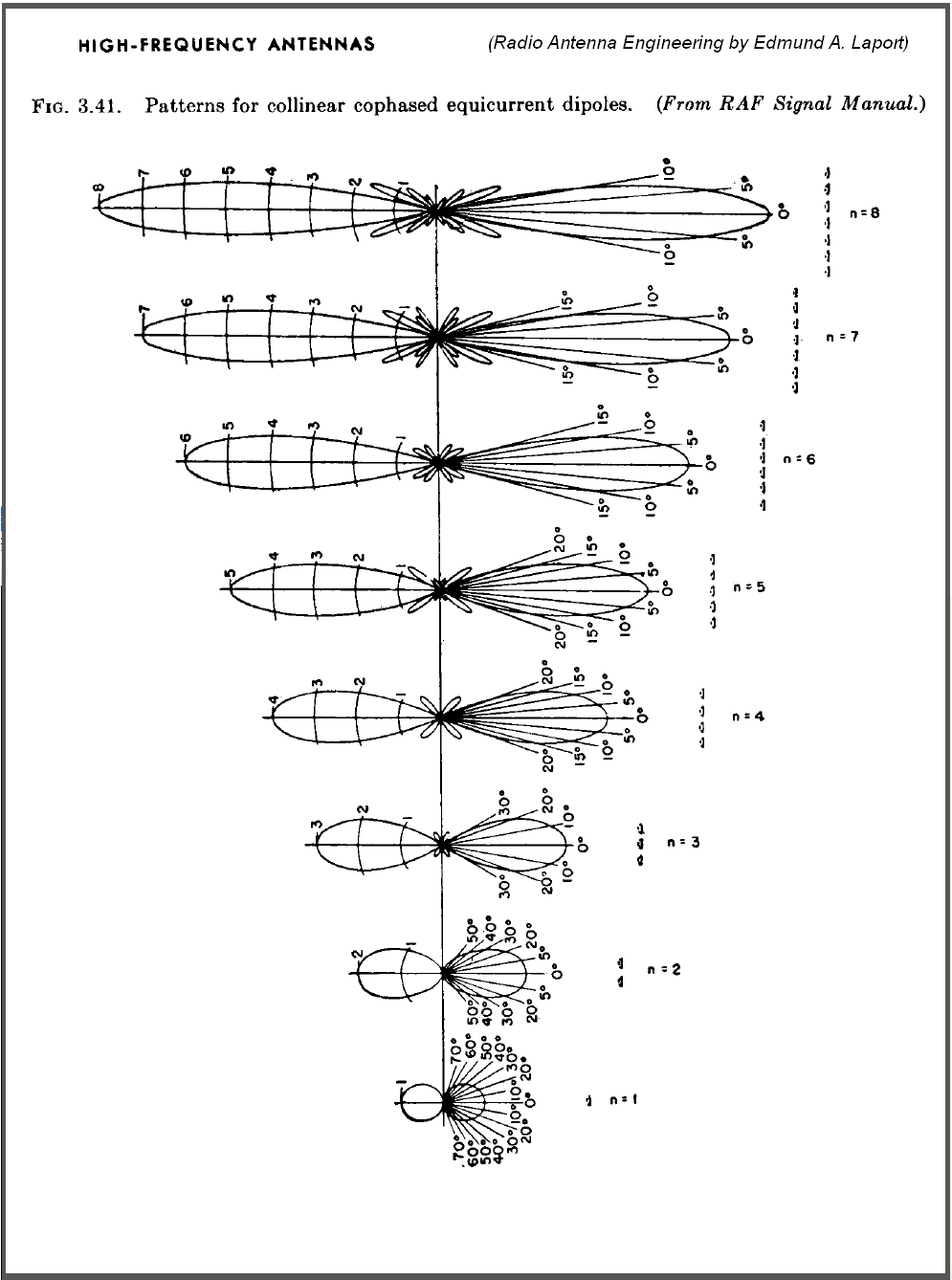

Keep in mind there’s usually a directionality-vs-gain tradeoff to make:
Vertical beam width: 9°
This is quite narrow; at 50km range, the top of the beam would only reach somewhere around 13k ft. (the “beam” is a fuzzy concept; this will be the -3dB point)
Of course you want the most gain for the aircraft closest to the horizon, but since you can already get out to the radio horizon with less gain, I’m not sure that more gain with a narrow beam is what you need here.
If you have achieved already the max range based on your position, this antenna will not increase it.
Maybe the message rate will be different/higher

Another 9 dBi Antenna
