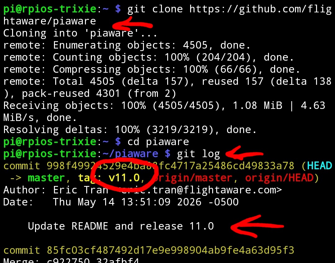

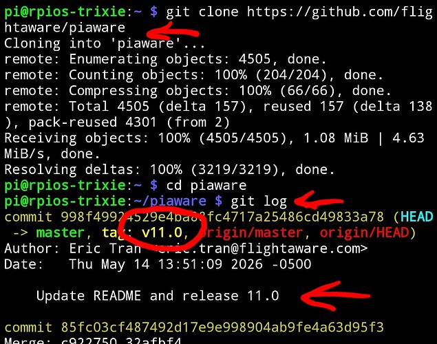

I checked Github just now. Only ver 11.0 is available. Please see screenshot below.
Ok, I have seen it there where there are also others versions
V11.1 is currently in the staging branch. It probably does not get offered up as an update via apt until it is merged into master.
The ver 11.1 is in staging state.
