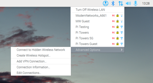

Did you use a full Rasbian OS ? If so there might be a networkmanager running when booting and that could still be claiming a DHCP address;
