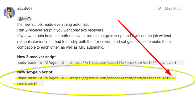

@abcd567 regarding your set-gain script, for two 1090 feeders, should I use the script with the master link or this temp one? I tried the master link but the gain values stayed the same for both feeders regardless of which one I change. I need to run your temp link below, correct?
Yes, use the new set-gain script “set-gain-2-receivers.sh”

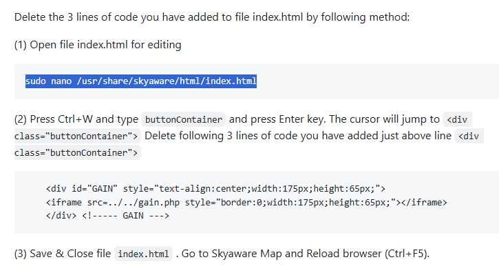

That worked but I had two gain buttons due to the 2nd install but your uninstall notes below helped me delete the duplicate set of the 3 lines …
The Skyaware2 gain button wasn’t updating the /etc/default/dump-fa2 gain values so I uninstalled both buttons and the associated other files per the uninstall steps. Might have been caused by the double gain + gain2 installs. I’ll try again later on a different clean install.

Regarding SET GAIN for piaware & piaware2, is this the correct script to create the two SET GAIN buttons?
sudo bash -c “$(wget -O - https://github.com/abcd567a/temp/raw/main/set-gain-2-rcvrs.sh)”
Yes, this is the right script.
