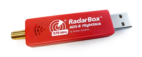

You may be able to improve your reception with a RadarBox red as it has both and amp and 978 filter.
Personaly, my first upgrade would be a better (and higher) antenna.

If your current setup is giving you everything you want, then no, an upgrade won’t help.
You currently have an amplified receiver, but no filter. Unless you do a broad frequency scan, you won’t know if the amp is helping or hurting.
Be aware SWR is not equivalent to gain.
A 50R resistor should give you an SWR of 1:1, but that doesn’t mean it’ll be a good antenna.
