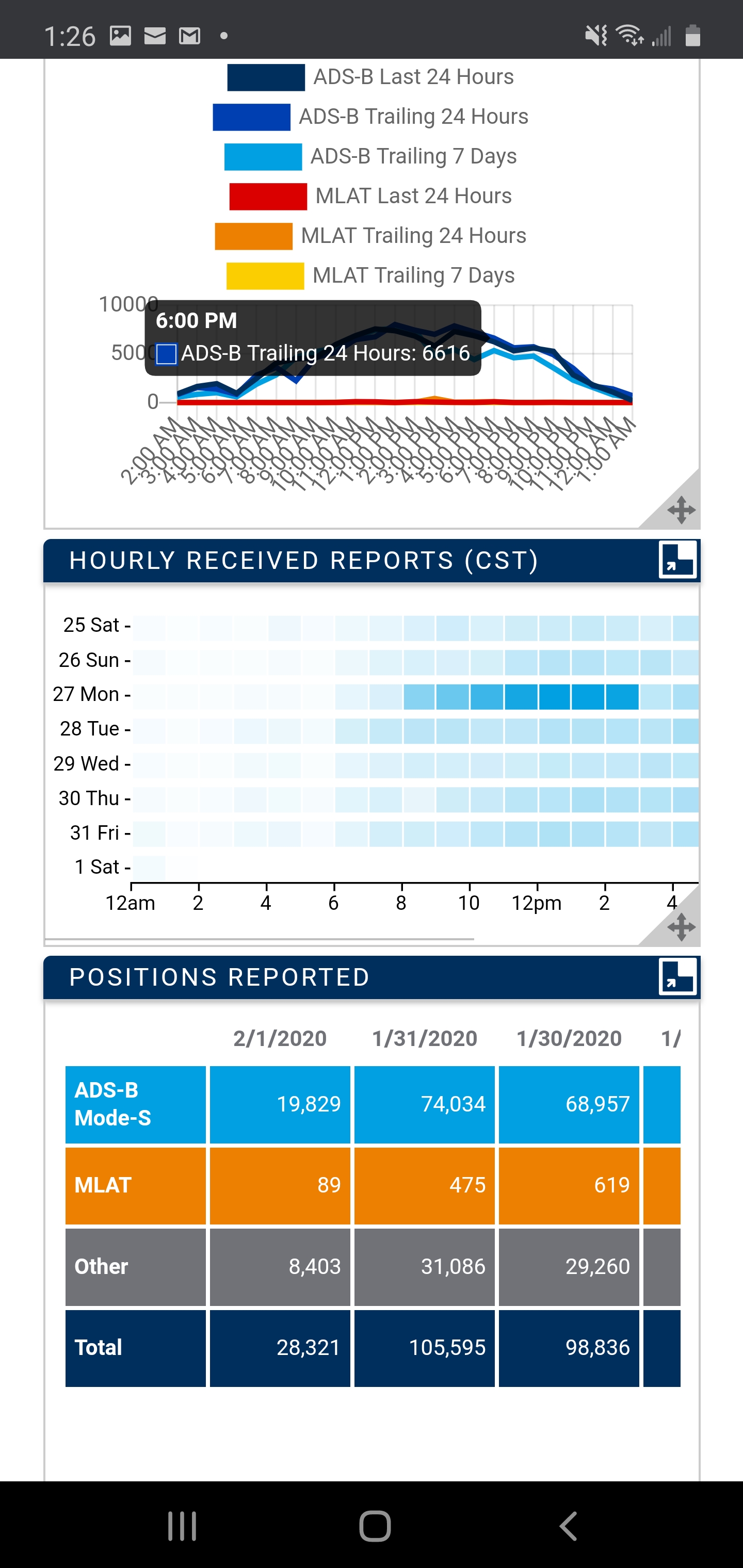

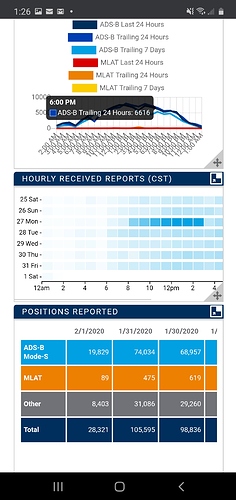

I have a 75 ft piece of lmr-600 that I tried out connecting to the flightaware antenna. I was really impressed with the outcome. Although impressed, my plan is to run the hole thing solar in a box and run ethernet to the router. That being said, there will be minimal coax loss and will be mounted on the tower about 30 ft up. I cant wait to get this going. My solar to usb should be in the mail next week to power the pi.
you can tell where I connected it up for a few hours that day.
What cable are you using the LMR600 against? That’s some nice results
