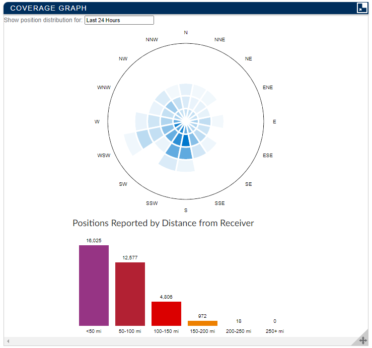

Rx range less than 50 miles
I bought/assembled the PiAware ADS-B Kit - 1090MHz PiAware ADS-B Kit – FlightAware. I have it hooked up in an area that should give plenty of coverage - horizon views above an elevated location.
My data is showing only aircraft within 50 miles. I can see KOSH operations during EAA without needing binoculars.

I have the pi and antenna out on an enclosed porch - no screens. To the west - unobstructed view for 40 miles and we are 300 feet above anything else. To the north, east and south - not elevated but clear horizons, no hills or buildings in the way.
Connectivity is good and tight. My biggest concern is the antenna that came with the package. It is listed as an indoor antenna (weather wise). Considering upgrading the antenna to something a little more robust. The kit also did not have a band pass filter with it.
I have another unit that I build from parts (not a kit) that I have running about 75 miles away from the one above. That setup has an outside antenna (pole mounted) and band pass filter. Reception for that unit is better. I think I could reach out further if I can elevate the antenna more. I don’t have graphs installed on that unit, but it is in my house and on my list to do once I have a few minutes.

I just got a picture of the setup. It is the orange receiver AND it has the blue band pass filter. I have removed the filter and am already seeing traffic further than 50 miles. Will post an update after if runs for a couple of days.
