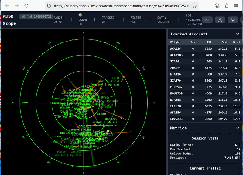

I think there was something wrong in downloading the file adsb-radar.htm from Github to Windows PC, although I used Identical method to download this file on both the Andriod Phone and on Windows PC. I also used identical configuration on both of these files.
Finally I decided to delete the downloaded file from Windows PC, and transfer the file adsb-radar.html from my Android Phone to Windows PC.
I have “Mobile to PC File Transfer” App installed on my Android Phone, and “FTP Manager Lite2” App on my Windows PC. Using these two, I transferred adsb-radar.html from my Samsung Phone to Windows 11 PC, and this one is running perfectly well
FTP App On Android Phone
FTP App On Windows PC
Settings in Transferred File adsb-radar.html
(192.168.12.24 is Local IP of RPi running dump1090-fa+Skyaware Map)
Transferred File Display in Firefox

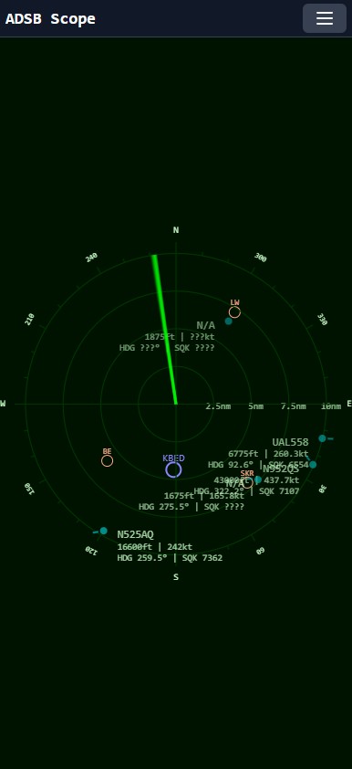

The requested mobile viewport
And now you can easily play with the settings

I now discovered why the adsb-radar.html directly downloaded from Github to Windows 11 Desktop was not working.
Nothing went wrong in the download. The culprit was Windows Notepad which I used to edit the TAR1090_URL and location info.
I fixed the issue by Resetting the Windows Notepad before using it for editing adsb-radar.html
Windows Settings >> Apps >> Installed Apps, scrolled to find "Notepad" clicked the ellipsis icon besides it (three horizontal dots ...) , selected Advanced options, and then clicked Reset.

On Android Phone, did a screen capture which created an .mp4 video. As this forum does not allow posting .mp4 video, converted the .mp4 video to animated .gif, which is posted below
Screen Captur on Android Phone
Screen_Recording_20250908_065756_Samsung Internet
Screen Capture on Windows 11 PC
ezgif-219f046cb99d34

I did NOT install anything anywhere. After downloading .zip file on Desktop, I unzipped it in a folder (again on Desktop). Then entered this folder, cd to “testing” folder, edited the adsb-radar.html for TAR1090_URL and location, saved, and double-clicked it to open it in default browser (Firefox)
I guess I was using the term “install” loosely. Anyway, the .html file is now index.html. You have to edit that, and you have to edit config.js.with the same information. Also DATA_PATHS need to be edited in the same files. These are the paths to the csv files. See the readme file in the testing folder.
