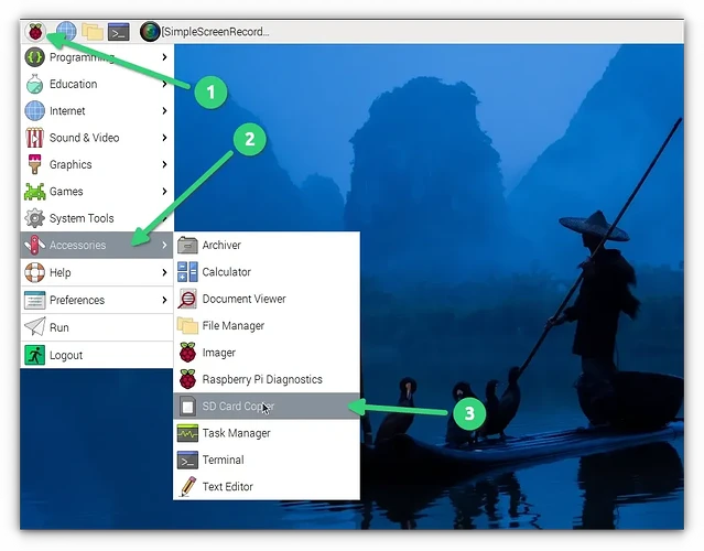

In this case go up tp bookworm. Once you prepare forst microSD card with all your apps installed, boot one of your Pi with that microSD card, and create it’s clones for use on other Pis.
https://itsfoss.com/raspberry-pi-clone-sd-card/
thanks, that will be the way to go tomorrow with some spare hardware to create the needed cards. Rainy weekend forecasted so an excellent time to get this job done :wink:
