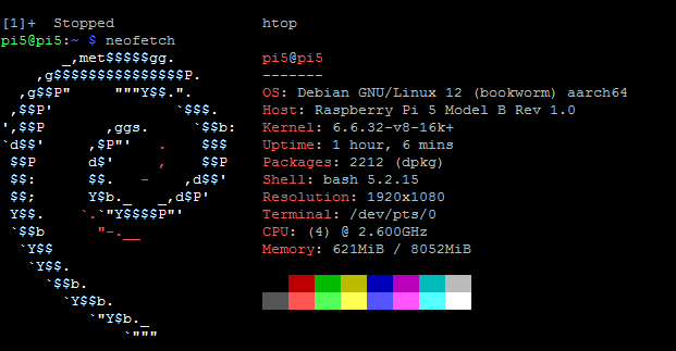

Hi abcd567
i tried and tried last night to get 256gb m.2 working with pi5 and bookworm
all is now working thanks to your work
Screenshot_490
had alot of trouble getting 9.0 over 9.01
thankyou
john
