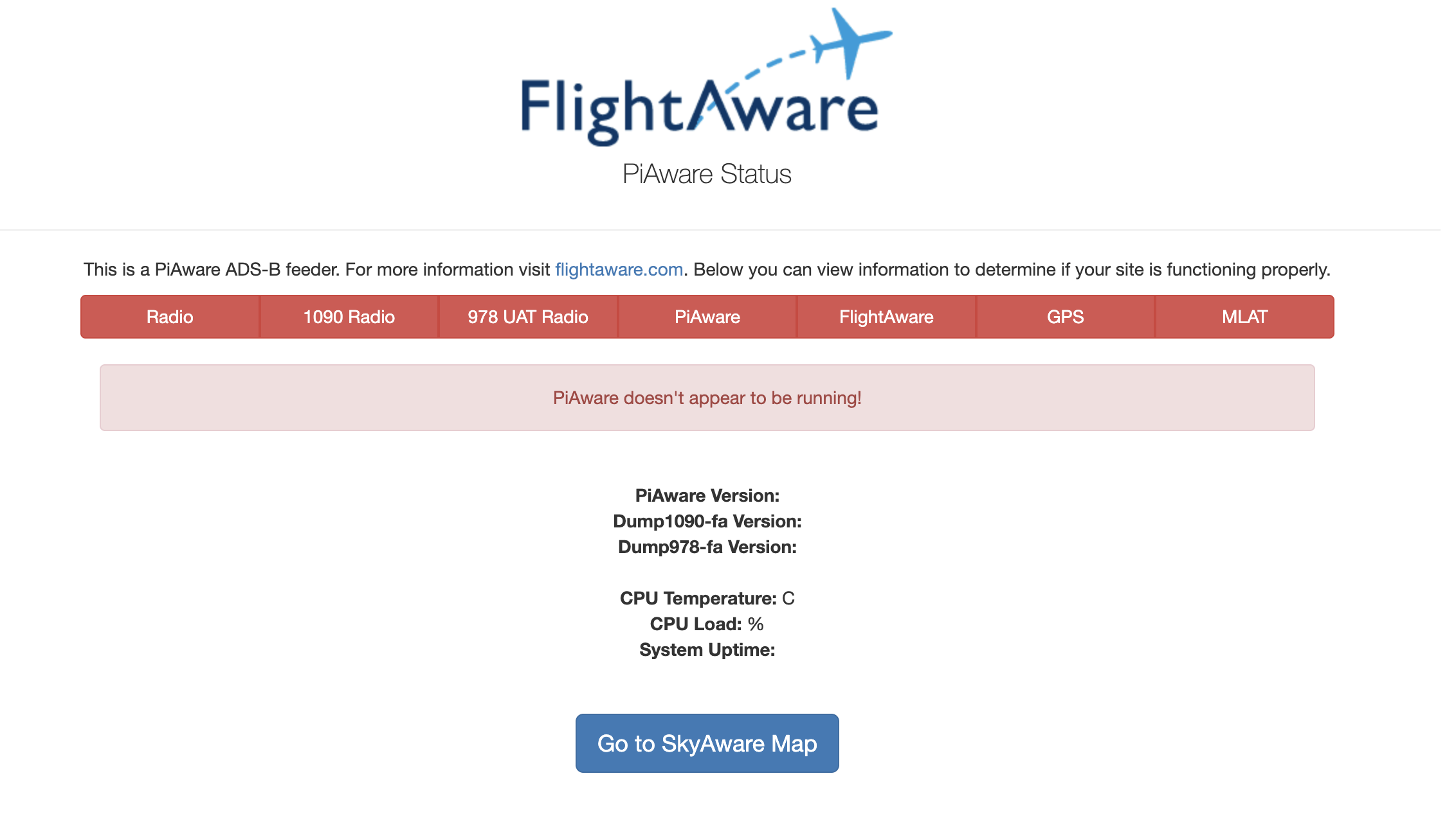

Piaware fails on fresh SD card image install
I had an SD card image install working flawlessly for a few years and recently I noticed that piaware was failing to start. I tried fixing this but of no avail. However dump1090 seemed to work fine as the map displayed aircrafts.
Finally, I decided to reimage the SD card afresh (https://www.flightaware.com/adsb/piaware/files/piaware-sd-card-10.2.img.zip) yesterday and then again today and both times even after fully updating the packages and firmware, piaware does not start:
The map continues to display okay.
