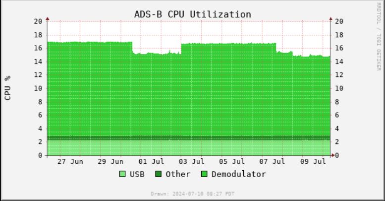

One other curiosity, when gain = max, CPU utilization is higher than when at 49.6.
The demodulator basically has two parts:
  1. scan every sample looking for something that might be a preamble pattern (a sequence of pulses at the start of every Mode S / ADS-B message)
  2. when we see a possible preamble pattern, try to decode the following samples and see if it is a valid message
Part (1) is an approximately constant CPU load, and (per sample) is cheap to run – it has to run on every sample, so it has to be cheap.
Part (2) is more expensive, which is why we only run it selectively.
When the gain is set higher, there’s more noise received, and there are more false positives in step (1) where noise is misinterpreted as a possible preamble. That means that part (2) needs to run more often, increasing the overall CPU load.
