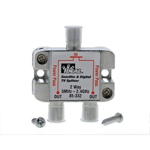

Price: US $7.98 :white_check_mark:
Frequency: 5 Mhz to 2.4 GHz :white_check_mark:
Insertion loss: 5 dB :x:
Isolation: 20 dB :white_check_mark:
Anyone having experience with panel antennas for 1090Mhz? It claims to have good gain which will help to focus on particular direction and then combine both signals will it be worth the effort?
