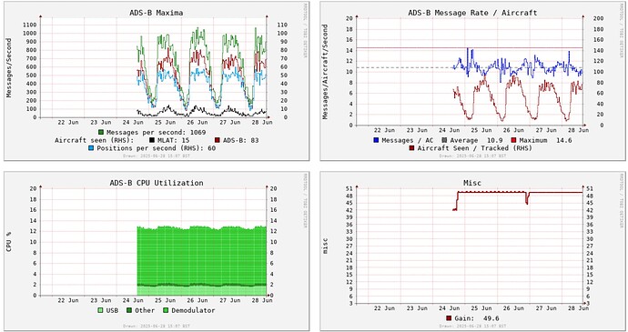

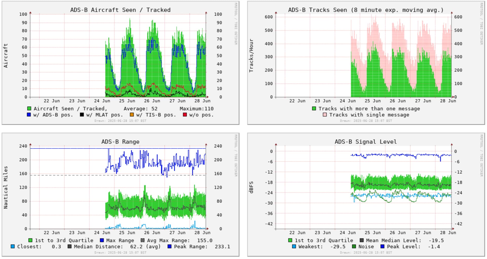

@tomvdhorst - I’ve installed the graph1090 and had it running since late this afternoon… Early views are:
Do you use an external filter in your setup?
In the Prostick Plus there is a filter behind the LNA and maybe you could benefit from an additional filter in front of the LNA (for example a barrel filter from FA).
Based on the first graphics I think the value of the weakest signals is high, 26,2 and with an additional filter you might get a better (lower) value there. That would improve the reception adding additional range and positions ( the further away the aircraft, the lower the signal strength)

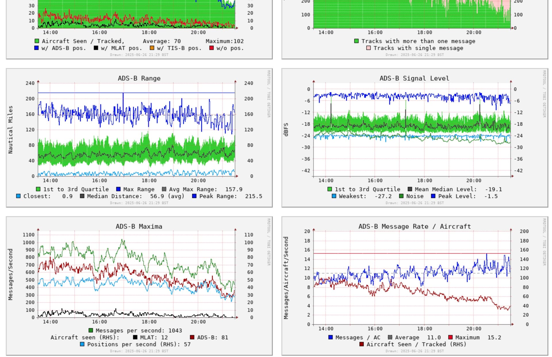

Filter has been on a couple of days now
What filter is this? Is it between the antenna and receiver?

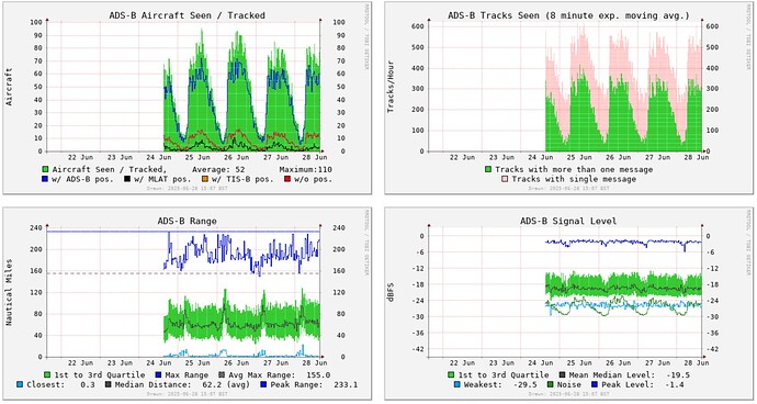

Can you show the performance over the last days from the start ? that gives some more insight, you can use the 7 days tab at the top.
Filter went on 3 days 19hrs ago
Looking at those graphs it looks to me that your reception has improved, you seem to get more aircraft and more positions with the filter in place. Since you didn’t have graphs1090 installed previously you could opt to run a few days without the filter to see if the removal has an impact on your performance.
