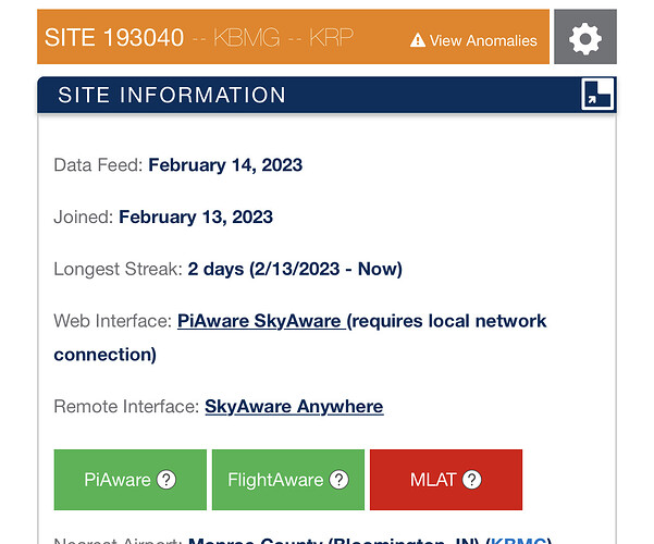

I am a newbie and I have everything setup with the exception of MLAT, I thought I had the config file setup but I still have a red MLAT showing up. Can someone direct me with instructions or help setup MLAT please?
Click on the gear icon and fill in your location details. They need to be fairly accurate.
Then restart piaware and you should be good (assuming you have enough other device nearby doing MLAT).
