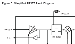

That’s true, but may not be quite as bad as it seems.
The 820t has a tracking band-pass filter that will reduce the effects of out-of-band signals.
The fact that many sites need external filters shows it’s not a panacea, but probably helps.
