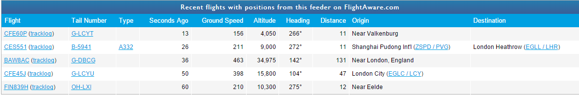

Finally, if the data I am sending you is not granular enough, how can you feed back the data shown below?

The granularity question comes from your advice that the data I send you is not granular enough to make a unit count of the positions I send yet you can tell me by feedback that at a certain time Tail Number G-LCYT was 11 miles away, you would have to extract A/C ID, Time, Lat & Lon in order to feed this back which to me would represent 1 unit on a position count.
That reflects a report which your feeder sent; the report does indeed tell us, for that aircraft, the time/lat/lon of the latest position that your feeder saw at the time of the report. But reports are not sent for every position message received. The rate at which reports are sent varies between feeder types and versions, so if you were to measure report rate, you’d really be measuring the software versions more than the real position rate received.
For example, a piaware receiver that sees one position every 5 seconds and a piaware receiver (running the same version) that sees one position every 2 seconds will generate approximately the same number of reports for that aircraft, because the minimum interval between piaware reports is 5 seconds. A planeplotter receiver that sees one position every 2 seconds might generate more or less than the equivalent piaware receiver, depending on aircraft altitude and whether it is maneuvering or not, because planeplotter uses a fixed interval and piaware uses a variable interval. I have explained this previously, I think.
