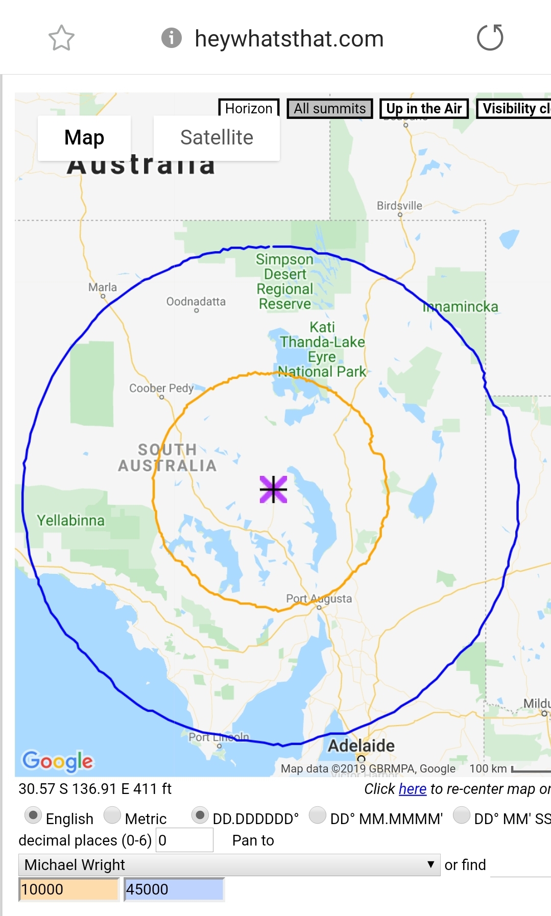

Yellow curve = aircrafts at 10,000 feet elevation
Blue curve = aircrafts at 45,000 feet elevation
Location of antenna = -30.57, 136.91
Height of antenna above ground = 30 feet (=411feet above sea)
