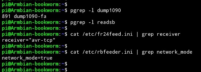

@Tomcraft1980
Since @wiedehopf suspects you have multiple decoders installed, so to check which decoders are running / installed, please post output of following commands:
pgrep -l dump1090
pgrep -l readsb
cat /etc/fr24feed.ini | grep receiver
cat /etc/rbfeeder.ini | grep network_mode

pi@piaware:~ $ pgrep -l dump1090
751 dump1090-fa
pi@piaware:~ $ pgrep -l readsb
pi@piaware:~ $ cat /etc/fr24feed.ini | grep receiver
receiver="beast-tcp"
pi@piaware:~ $ cat /etc/rbfeeder.ini | grep network_mode
network_mode=true
pi@piaware:~ $
