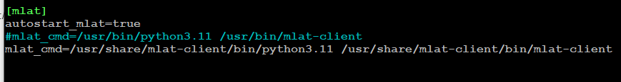

(6) Test-run on Radarbox24 feeder
sudo nano /etc/rbfeeder.ini
Commented-out line starting with mlat_cmd=
Added following line:
mlat_cmd=/usr/share/mlat-client/bin/python3.11  /usr/share/mlat-client/bin/mlat-client
sudo systemctl restart rbfeeder
sudo systemctl status rbfeeder
