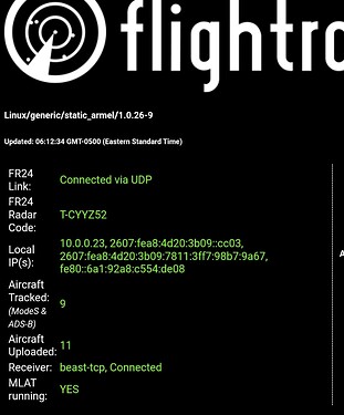

I have posted the method after testing dump1090-fa with fr24feed having settings bs=yes and raw=yes and it works ok. Please see screenshots below.
