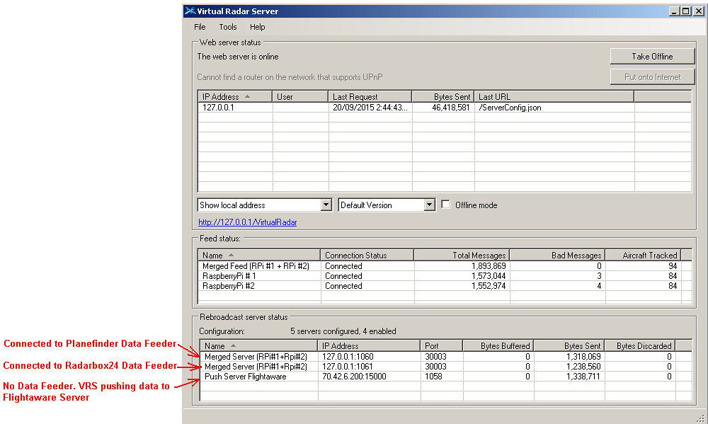

After reading your above post, and seeing the configuration at http://flightaware.com/adsb/sbs3/ (IP address & Port number), I configured a “Push Server” in the VRS few minutes ago.
I dont know how successful or correct it is, but it did start sending data from VRS using merged feed from my 2 RPis, but if a DVB-T & RTL1090 is configured on windows, it will send data from windows DVB-T.
QUESTION: What is my station ID???
SCREENSHOT 1 OF 2
SCREENSHOT 2 OF 2
