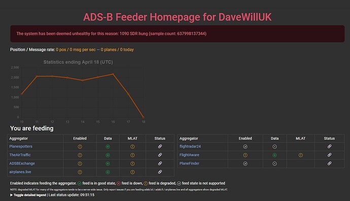

Houston ? We have a problem!
All of a sudden it looks like something is broken and I don’t know where to start to try to resolve it so if someone can assist I would really appreciate it
I tried a reboot of the physical device and now I cannot access the interface at all which is not a good sign.

The system tells you that the connection with the dongle is lost.
