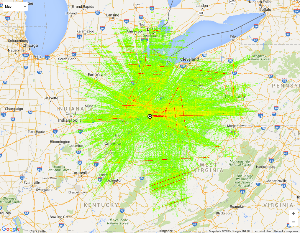

One week of data. I bumped the resolution up to 4000 from 1000 and the max points up to 4,000,000 from 400,000. The heatmap makes it obvious where the obstructions are around my antenna. Need another 20’ above current location on the roof.
Cheers!
LitterBug
